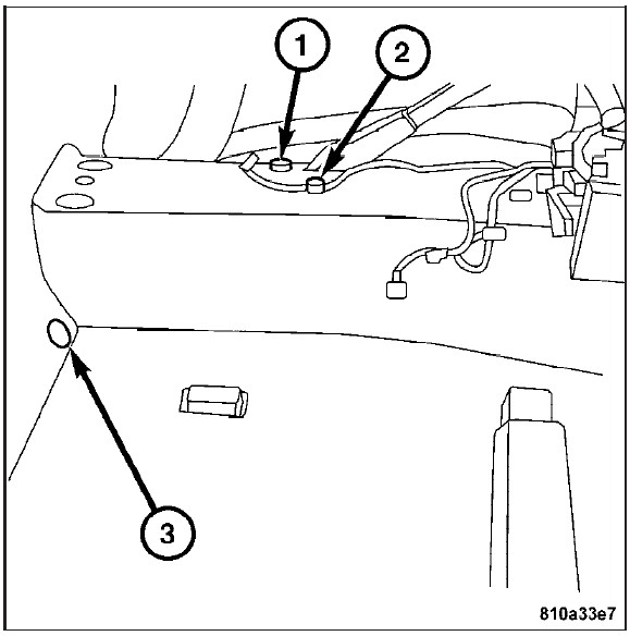

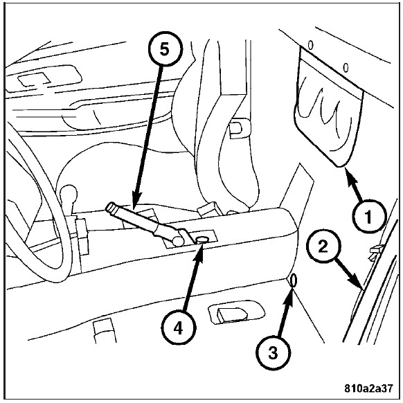

Je ne sais pas si ça pourra t'aider :
"PARKING BRAKE
Note: Parking brake adjustment is controlled by an equalizer cable tensioner and does require adjustment.
The only adjustment that may be necessary would be to the equalizer tensioning bolt.
The parking brake switch is in circuit with the red warning lamp in the dash. The switch will cause the lamp to illuminate only when the parking brakes are applied. If the lamp remains on after parking brake release, the switch or wires are faulty.
If the red lamp comes on a fault has occurred in the front or rear brake hydraulic system.
If the red warning lamp and yellow warning lamp come on, the electronic brake distribution may be at fault.
In most cases, the actual cause of an improperly functioning parking brake (too loose/too tight/won’t hold), can be traced to a parking brake component.
Note: The leading cause of improper parking brake operation, is excessive clearance between the parking brake shoes and the shoe braking surface. Excessive clearance is a result of lining and/or drum wear, drum surface machined oversize."
C'est le n°4, le parking brake switch :
feu de recul Copie_10
La dessus, c'est le n°1 :

MessageSujet: Re: feu de recul   feu de recul I_icon_minitimeMar 21 Fév 2012, 11:46
Dis Jippi, j'vois pas trop le rapport avec les feux de recul , mais bon, j'dis ça ,j'dis rien ... Rolling Eyes Idea
feu de recul Empty
MessageSujet: Re: feu de recul   feu de recul I_icon_minitimeMar 21 Fév 2012, 11:58
Mais t'as raison, j'ai lu de travers ! J'ai cru qu'il s'agissait du contacteur de frein à main !!!
